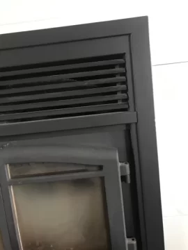

There isn't a great option for chimney pipe. The insulation is too thick for surface reading to be meaningful and the chimney pipe shouldn't be violated. Can you fit a 2" dial thermometer on the stove face above one of the door corners?
[Hearth.com] zero clearance wood stove chimney temps
Maybe? There is not much clearance there though
Yes, measure there and see if a 2-2.5" round magnetic thermometer could fit there. If not, maybe use an IR thermometer to take a reading there.
Face temps are going to be relative to the size of the fire, wood species, split size and how quickly the air is turned down. Keep it below 700F at that location and it should be ok.
Yes So that’s where the problem is. That specific way of taking temps is much the same as the infrared thermometer it’s not accurate,really. What I’d like is to somehow be able to take a reading of the temp in the chimney as that will give me the most accuracy to maintain a optimum burn and reduce the chances of any build-up in the chimney that could cause a chimney fire. What I was hoping is that someone has a method of getting some type of thermometer inside the chimney(safely of course) just above the stove somewhere and I could see exactly how efficiently the wood is burning in the stove.
