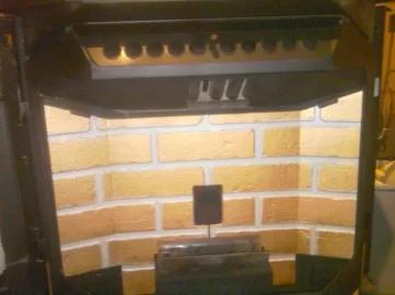

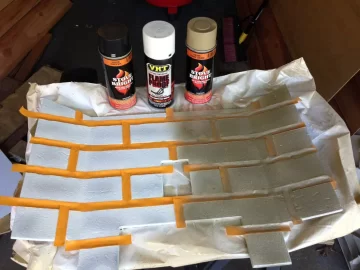

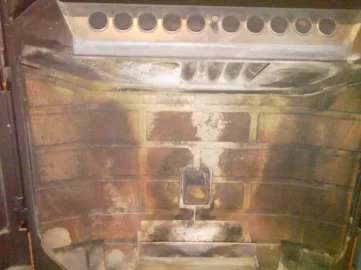

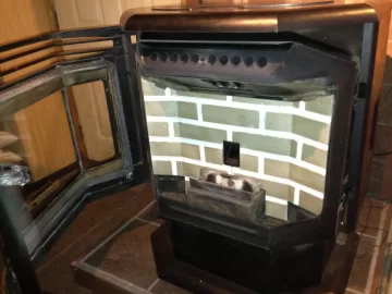

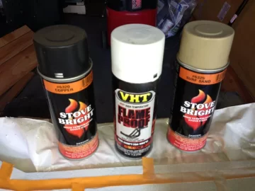

You can remove it and paint it, here is what I did.
Which color scheme do you like better?
I painted the entire firebox and top heat exchanger baffles VHT Flame Proof 2,000 Deg F flat black.
Then painted the back of the fire box flat black.
Then 1200 Deg F Stove Bright copper on the firebrick with the Surf Sand on the mortar for 1 finish look
or
White VHT flame proof for the mortar and Stove Bright SurfSand for the firebrick in the last pic!
