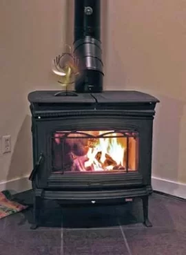

I had to put an offset in the flue when I switched from the F400 to the T6. Although at first I was opposed to it, now I hardly notice it.

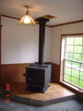

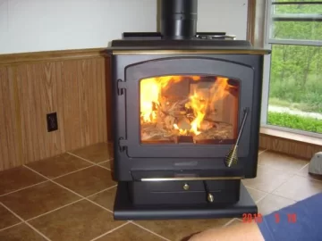

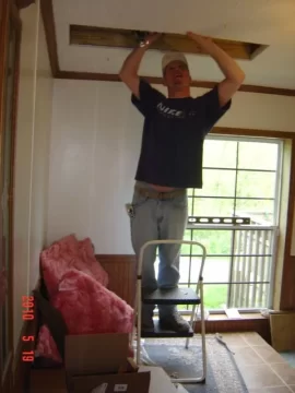

Finally got the chimney install finished and eveything turned out great. Ended up double bracing the ceiling joists on each side then heading off the one we had to cut , had to cut a little bigger area of drywall from the ceiling to get in to the work area , so i guess my buddy that does drywall will have something to do .
Very nice installation.
