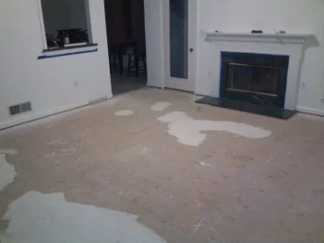

I really would like to replace the current prefab I have in my living room upstairs, which is a Superior RD-3800A (part of Lennox) From what I recall, it said it's better to operate the unit with the glass doors closed and the fresh air inlet open than it is to run with the doors open. We like the ambiance but the heat output is rather minimal since it's more for "show". I've attached a picture (not the best quality, sorry) that shows the fireplace, the pic is from when we purchased the house and removed the old flooring. The fireplace is sort of "floating", surrounded by marble on all sides, even on the bottom. It's not resting directly against the hearth. I would love to completely remove the prefab box and put in a stove, but I'm having a rough time finding one that fits the dimensions nicely (20.75" high, 38.5" wide) The mantel has a 49.25" (high and wide) opening, but the remainder of that space is taken up by the marble slabs.

I'm not sure if you are talking about a freestanding stove, or a high eff. zero clearance fireplace. In order to put in a stove, lots of things need to change unless it sits out in front of the chase that the fireplace is in. You can remove the fireplace, mantel and marble and replace it with a pre-fab high eff unit, with pretty minor demolition. The Z-42 that I mentioned earlier is a pretty good fit in the space that you have. (broken link removed to http://www.kozyheat.com/products/woodburning/z42/index.html)
Either way you go, there will be demolition. The "chimney" on that prefab will not be rated for a solid fuel appliance. Once the demo is done, you can re-frame for a ZC type unit, or set up for a free standing in the general space. Many opt for that option. The one, and to me main difference, is the free stander can and will heat your home when the power is out.
