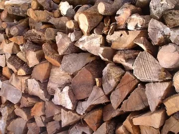

    It's a sub-species of evergreen oak: Quercus ilex rotundifolia (picture below). Also olive, both so well seasoned (split spring 2007) that I can completely close the damper after five minutes without any sign of smoke from the chimney when reloading over coals glowing bright orange. I've also got a big pile of almond but it's a bit suspect though as it's only been split nine months.
    I tried some of the evergreen oak last March and it was a bit like that almost one year after being split. Your long lasting coalbed also makes me think the wood might need a tad more seasoning, but it may just be that soapstone liner retaining the heat.

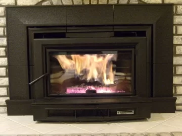

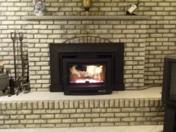

    OK, Finally got around to assembly and installation of the surround. So this project is pretty much complete now. I am left thinking what I can do to address the brick arch that shows above the surround. perhaps paint it black or try to find some form of appointment, maybe a cast iron piece cut to match the arch and finish it off..
    Any ideas on finishing off the arch surround would be greatly appreciated..
    Thanks again to this forum for the educational experience provided..

    It looks really cool. I'm not sure about the brick arch. I wouldn't paint it though; once you paint it there's no going back and it looks fine as it is. Some sort of iron trim like you said might work well too. How are you getting on with your fires now you've burned it a few times?
