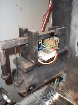

However, depending on the boiler and the strength of your natural draft you may find that the coals get enough air to turn to ash even with the draft fan turns off. Because of this problem I ended up with the draft control pictured above that shuts the draft inlet off completely when the draft fan shuts off.
