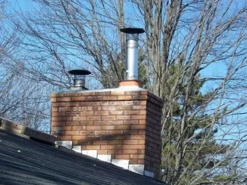

I added 18" of 6" stainless to one of my flues and was wondering the same thing about it not being insulated and turning into a creosote factory but I'm thinking as long as you burn dry wood you should be ok. I will check mine about once per month to make sure.

I added the rigid liner to mine to gain height (6 in diameter) then put a 7 in piece of rigid around that and used rock wool between them to insulate. Basically, I made a homemade double wall pipe. I kept the cap on the 6 in liner in doing this.
Here is the best pic I have of this setup right now. These are about the most unflattering pictures possible. From normal viewing distance, it really doesn't look that bad at all.

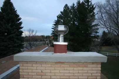

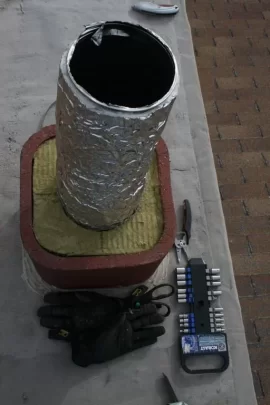

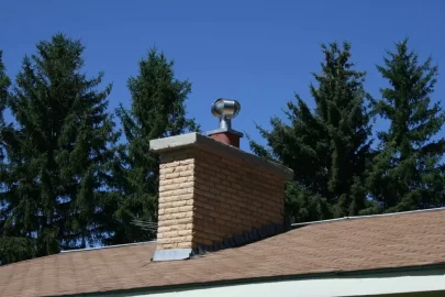

I extended my terracotta flue by one round and brought the insulated liner up to the top plate. Here's what the "revised" chimney looks like at eye level, from below and during installation:
