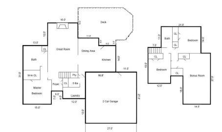

    Looking to install a gas insert into our zero clearance fireplace to use as a zone heater and reduce our heating costs. The main room is about 28-18 with 10 foot ceilings and is the location of the fireplace. We would like to keep this room warm with a little bit of heat transfered into the master bedroom and kitchen/dining room which are attached (see floor plan). The opening height if our existing fireplace is only 19 inches so we have limited options. We meet with the fireplace store today and they recommended the archgard 22-dv124n. It's output is 17-24k btu per hour. Will this be sufficient to meet our needs?

    I over guessed on room size. It is actually 16x26

    We currently have a heat pump with electric resistance backup up heat only which runs a lot when the temp is under 30 (which is quite often). The whole house is about 2400 sf but we pretty much don't use the upstairs during the winter.
    The idea with the gas fireplace would be to hear the living room where we spent 95% of waking hours. I would think this would be cheaper than heating the whole house with electric.
    The unit itself was 2050. Another 450 for the direct vent pipe system, plus extras to upgrade to 4 sided surround, lp conversion, and remote with thermostat
    The house is tight with high quality casement windows, well insulated walls, and well insulated with blown in insulation in attic.
