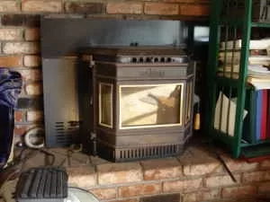

I bought a used whitfield pellets stove. First issues was that the auger would turn off in about an hour and not start up even a few hours later. Now it will start sometimes, but it will over feed. I've heard stories when the pellets over fill than it will start all the stored pellets on fire. I am afraid to keep the stove going after i go to sleep. Pleae help.

Since you bought the stove used, First I would start with the basics and make sure the stove internals have been completely cleaned. Make sure all blowers are clean and working and make sure all sensors are clean. Once your sure you have a thoroughly clean stove try again and see if you get the same results. If you dont have a manual for the stove, you should be able to download one online to help with the cleanup and troubleshooting.
Second, and this is just a safety tip: I would move those combustionible papers a little further away.
