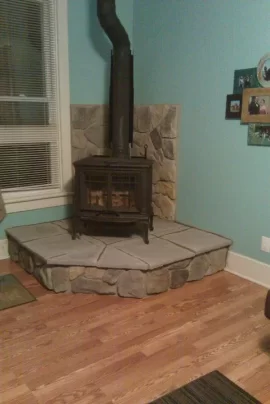

Thanks everyone for being so welcoming and helpful. This is a photo of our install;
