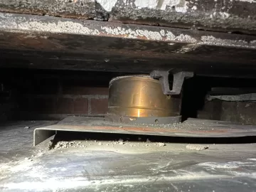

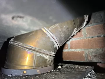

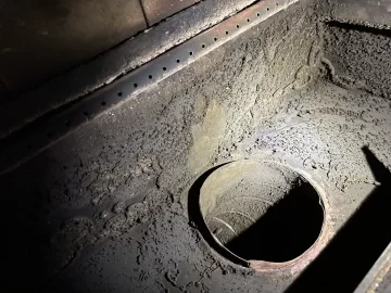

Very difficult to remove this liner from my insert - looking to swap inserts with a newer one.
I removed a screw from the back of the collar - but this is still not budging.
Any suggestions are welcome!
Would it be wrong to use a hacksaw to cut this above my insert, I can then feed a sleeve or connector or extension on to connect to new insert after?
Your probably going to have to lift the liner up from the top
Wouldn't this be more difficult than just cutting the bottom bit off and attaching a piece onto the bottom that will connect to the new insert?
If this is the general advice I will do that for sure, just curious!
But how will you get the new stove under it without lifting the liner?
I imagined some sort of sleeve I could slide up the liner , insert stove, slide down the attachment, and fasten.
But - I believe lifting the liner will be the route I'll take as that seems to be the norm and I'm not sure what I imagine even exists haha.
Thank you!
