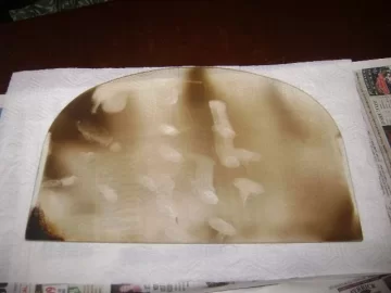

This is our first year with a VC Winterwarm lg, first year burning wood for that matter.
Some of the things I have noticed is that after the few over night burns we have done, the glass soots up pretty bad both side towards the bottom in a triangle shape up each side.
I usually load up at night with walnut that is well seasoned (around 15%). I thought I was getting it going well but then turning it down to about 1/3 on the air.
tonight I had it going pretty hot and the glass was clearing up some and with the air turned all the way down it continued to have strong flames and the cat was going great. Then due to the heavy snow we got, the power went off and it continued to burn stronger with out the blower going.
I noticed the Rutland thermo I stuck on the front of the stove was higher than I have ever seen it read (250-300F) on the surface just about the door and levers.
I noticed some new smells and metal popping a small amount but nothing was glowing.
The power came back on after about 20 minutes so I cranked up the blower and it cooled slightly, so I opened the damper just to see how quick it would slow for future reference.
Now my questions are- Did I finally get it were it actually needs to be to burn right? The glass didn't clear all the way up, but did clear some.
Is there a better place to mount or get a temp reading on a VC Winterwam? Should I just get an IR them and try to aim it in the narrow gap back towards the flue?
Thanks
