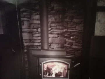

identify what kind of stone is behind this stove ??

Could anyone tell me what kind of stone this is ? I want to put it behind my stove. Thanks

You are the man !!! That's it thanks so much !!
If you live in eastern Pa, this is the home for that stuff. I lay the full stones of that in walls all summer long and it's called colonial. When they cut it for use like this is generally referred to as veneer. There are artificial versions but I am not certain about their resistance to heat.
Here's a website of a local stone yard for me. http://diazstoneandpallet.com/veneers.htm

It does not attach as easily as tile does. If it's your first job expect it to take far longer than you'd expect. I'd call around to some locals who do the work and get an estimate. I'm not meaning to promote that business, just displayed it for the images, but if you call them (or anyone around you who sells that stuff) for the price of the stone to do that area you'd at least get an idea for the material cost then you'd be better able to judge the cost of installation.
