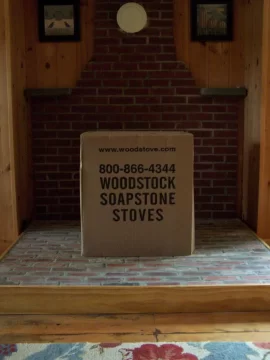

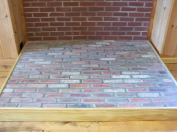

    No, just kept sponging the bricks off with water. Is it too late to do the acid wash? What's up with doing that? After reading about it, I don't know if I want to use it indoors. Also I already have my wood trim on. I read you have to keep washing it down. Wondering if it will turn into a major mess trying to get all the acid diluted back out.

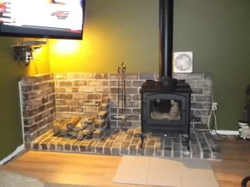

    Looks great - I used water based poly to seal mine. Not for necessity - just asthetics. I used satin finish and just brushed it on with an old paint brush. Again, not necessary for function but I liked how it brought out a little shine. My bricks were road pavers and driven on for about 80+ years so they needed a little TLC. Finished Stove 016.JPG

    I'm wondering if your seeing the whitish bricks, that you mentioned the acid wash. These are old reclaimed bricks so they have been like that for who knows how many years. They were cleaned off with water and sponge before things got too dry. They just have that weathered look.

    Yes, it's not clear from the picture how much of the whitish brick is from the dried mortar after wiping off the bricks. The acid wash would be to clear off haze left by the mortar. It can be done now without problems. Cleaning it off is a little hassle, but not a big deal. You can neutralize the acid after the wash with baking soda or lime. But if you like the look at it's current level then leave it.

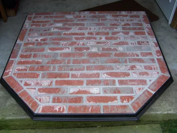

    Our former used brick hearth pad had the same look, that was a manufactured pad.
