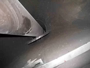

my fireplace opening is 20 3/4"high and 35" wide, where and what can I get to put in here for glass doors? Please ignore the pipe inside the fire place the previous owner had an external fire place hooked up to it.

Lowe's and Home Depot both should be able to order fireplace doors for it if they don't have them in stock. If you are going to use that as a regular fireplace be sure to make sure the damper frame wasn't cut out for installation of that chimney liner. If it was you are going to have to install a chimney top damper.
Original fireplace damper fit into a cast iron frame in the top of the fireplace at the base of the chimney. If you are going to use that as a fireplace that liner has to come out. Completely.
What's the chimney lined with?

Is that a factory built fireplace? It looks like it but the picture is kind of small. If it is you will need to use the specific parts from the manufacturer.

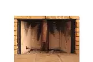

Thank you, I have no idea what its lined with, here is a pic before I removed the smaller pipe, now I have the door closed and it fits properly.

Gotta be a pre-fab with that steel smoke chamber and flap damper. With the missing damper rod.
