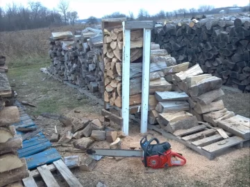

    This is what I built. Works well.

    This is what I mentioned earlier...nice. What size bar on your saw? How wide is your rack?

    That's a 28 in the pic, but I made it to work with a 20. Depends on what I want to run that day. It's 16" deep, so I have room for error. I run the dogs an inch or so away from the frame and they end up about right.
    I'm about done with the box. You can have it, but it doesn't come with the saw ;lol

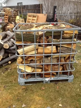

    I'm going to just stay out of this one and keep filling my bins! Pat

    curber,
    How do you make those bins? I can see some uses other than firewood. I see pallets in the background. That's what I usually use.

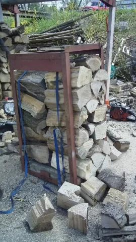

    same basic idea but metal...ratchet straps are key.

    The bins are a 275 gallon tote tank with the liner removed.
    Like the one pictured.

    Boy that metal would scare me, on mine I run my saw close to the uprights and hit them at times. I would ruin a chain on a metal stand.
    But yours will long outlast my wooden one by a long shot.

    That is the trade off. The nice thing about using metal and the ratchet straps is the wood does not move at all while you are cutting it. The frame is about 4' tall and you cut both sides every time you start the saw for a pretty decent sized batch. I cut well away from the metal and it is pretty fast with the 24" bar.
