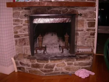

My open fireplace, which we use a decent amount for ambiance weekend fires, sometimes puffed wisps of smoke out the front. By reading the forums here I learned that I should make sure the fireplace opening and flue diameter were at the proper ratio. Well, with some experimentation I found that the draft would improve a lot if I narrowed the opening about 2 inches. The pic below shows my temporary solution. Basically I just cut some hardware cloth and wrapped aluminum foil around it and hung it at the top of the opening. Well, of course I want to make something that looks better than that. So, I plan on fabricating something out of sheet metal. Questions for forum members:
1) what gauge metal to use (I don't want it to twist but I also don't want it to be really heavy)
2) what kind of metal should I use? Regular old steel? Galvanized? Aluminum?
3) how do I turn it black so that it will fade into the opening. Use stove paint?
