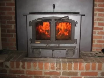

    I have an older sierra rear venting wood stove and was interested in putting secondary burn tubes in it. Has anyone ever done this or can it not be done on a rear venting stove? Looking at building my own if its possible.

    This Sierra T-4500 heated this two story 2,500 sq. foot barn for 21 years. Unfortunately this pic was taken the night after I installed a liner and with the new monster draft I discovered the crack in the firebox behind the baffle and it ran away on me. Pulled it out and replaced it a week later.
    I miss that stove. Even though the replacement heats the joint better with half the wood. Just had a lot of history with Old Brownie. Two thirds shut down and with those blue flames rolling under the baffle and no smoke out of the chimney the sucker would burn forever.
