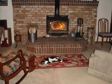

Oh gosh, it depends on so many things. I'm not tall, but I'm not getting any younger, either, so I'm not real fond of bending over. We had raised brick hearths built for both of our stoves to sit on, ~12" above the floor. I'll attach a pic of one. No idea whether or not it's applicable in your case, but it's a thought. Welcome, and good luck! Rick

Correct, there's no rule that you can't raise the stove up as long as the clearance to combustibles above the stove are honored. I've seen installations where the hearth is 18" high and has wood storage underneath it.
looks like the cat has the "best seat in the house" bet that feels GOOOOOOOD!!!!!
beautiful job on the hearth by the way , that photo could be used in a brochure easily, nice work all around!

I fear the cat might be the next thing to "char" ... like a ferret :p
