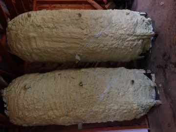

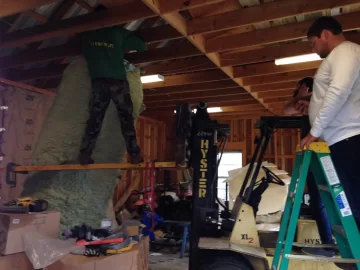

Here's some ideas for your brainstorming. My welder welded nipples that were longer than my planned 4" of foam to the tanks. We welded 2 heavy angles on both sides so the fork lift could handle the tanks vertically with foam inside the 10' ceiling. We set the tanks on the flatbed for the foamer. The forklift carried the foamed tanks into the barn vertical and set in place. Then we cut the handling angles flush with the foam. The day may come when I add another 500 gal for a 1500 total. But gonna start with 1000 gal. I wanted vertical mainly to save floor space but I had a 10' ceiling and a very thick slab in that location. First pic shows the forks supporting the tanks over half way up (kinda dark sorry). Second the final resting place. These things are scary heavy to handle in close spaces. Moving the 500's was plenty a handful. 1000's would be exciting but I wasn't able to move with a sling with the rafters. Lots of ways to skin this cat, this is just how we did it. Hope it helps. Best wishes.
1000 Gallon  Propane Tanks stacked storage
