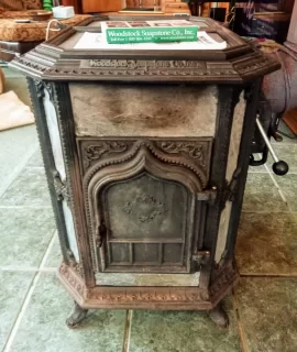

Went by to check out a 15+ year old soapstone stove, so what should I double check?
  • It's a Woodstock Fireview 205.
  • Age is estimate b/c the serial plate is hard to read now and it's 2nd homeowner but the original owner left behind a VHS tape from Woodstock Co.! :D Mid to late 1990s?
  • There is one soapstone cracked in the back facing. Woodstock lists this as part# W-15, worth $28, and says these stoves are double-line stone so maybe that's possible to repair/replace?
  • There is some rust on the cast iron frame even though the stove is sitting in a den, so maybe high indoor humidity caused slight rusting? Heavy duty wire brush this or re-paint it?

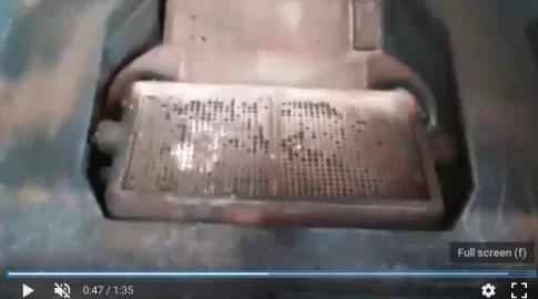

  • The combuster top / cover for catalyst looks to be damaged -- there is was a 1-inch area that has collasped. I didn't get to the cat itself but I'd assume both need replacing, so that'd be about $200.

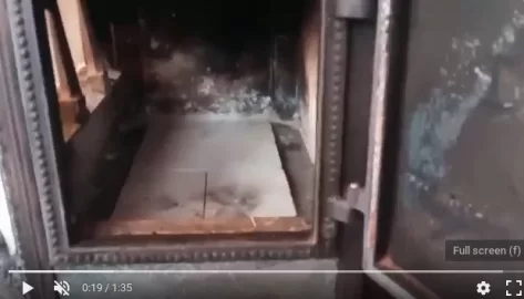

  • Damper control works. Glass is relatively clear (slight haze but not cracked or black). Doors easily swing open / shut.
  • Its current owner has another fireplace and wants this stove gone because they're remodelling the den, and only fired it a few times since moving in.
  • The thing was remarkable clean, even in the firebox, and the flu ... but the current owner's use & care gives me no clue as to how the previous owner used it.
What worries me: there was no thermometer, neither on the stove top or the stove pipe.
So how would I tell if the stove was overfired? the broken soapstone a sign?

I think he's saying that the combustor scoop is warped 1". Same as my SIL's used Fireview was..it had the original cast iron scoop, not the newer stainless scoop. I replaced that, but you wouldn't have to. Not sure what the damage he's describing consists of..??
Look at the bypass door frame where the flame exits the box when the bypass door is open. If that's warped, severe over-firing has been administered to the stove.
What cat is in it? Ceramic would indicate it hasn't been replaced in quite a few years..may well be due for a new one. You're talking $150-180, ceramic or steel are available. You'll need a new one every few years.
I'll check. Elsewhere I didn't see any signs of warping.
Have you got any pics?
My phone's camera sucks but yes.
[Hearth.com] 15+ old soapstone: overfired?[Hearth.com] 15+ old soapstone: overfired?[Hearth.com] 15+ old soapstone: overfired?
That's a bit pricey for a 15yr old stove that needs work. Remember back then they sold for what $1600? Offer $800.

Yeah, if it's in decent shape, maybe give 'em 1K$. That rust is nothing to worry about.

Turn around and throw it again. ;lol I have a new theory about the rust; Guy burned marginally dry wood, heat wasn't great so he got the stack robber. Stack robber sucked the heat out of the flue gasses, creo condensed and ran back down to the elbow. The upside is, the stove probably wasn't overfired..not much heat was created. ;lol

For sure, remove the lid, door and bricks. It probably has the old cast iron cat housing and cat scoop. You can lift out the cat/housing assembly as one piece, or they may still have the shipping bolts in the housing. Then there's one bolt holding in the cat scoop inside the box, I think.
