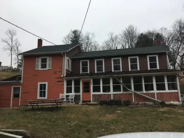

Enjoy your new hobby. I'm renovating a 1906 farmhouse which came with two propane space heaters and a non-working through the wall AC.

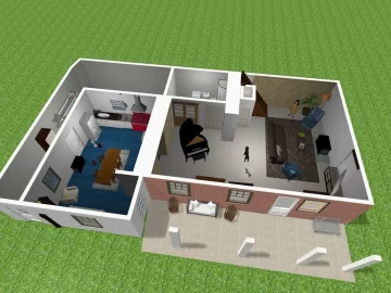

That's a serious undertaking. Can you post a quick sketch of the floorplans and where you are thinking of placing the stove(s)? It looks like there are two chimneys, one on each end. Are they serviceable and in good locations?

Aye. Here’s the sketch of the ground floor, my work in progress vision. Stoves are located where the chimneys are.
Chimneys look good, cinder block, one noticeable crack on one but it isn’t large. Just had them sweeped, no concerns noted. I think the tech said it was a 6 3/4 inch flue size.

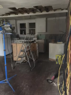

The plan is... yes I’ll be living there during renovations. No doubt this will be a rough experience, take a look at the picture of the kitchen as it is right now… I have my primary home for sale right now and as soon as that sells and closes, I’ll make that jump. I do own a vacation rental property that I can stay in if electric and plumbing aren’t done at that time.

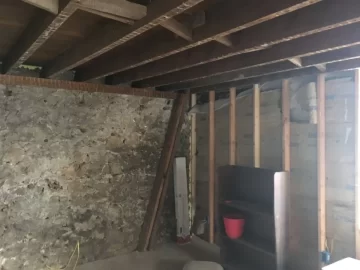

In 2014, I think the previous owners took down a bunch of interior walls exposing lime stone foundation and brick walls. Only two limestone walls been framed up, but has not been dry walled yet - and one of those hosts a chimney. See pic. So getting the right chimney in place before work continues is key. Upstairs, it’s a mixture of plaster and lathe as well as drywall on the new were 1920 addition. Upstairs is in relatively good condition. But I am not sure if there is any insulation between drywall and brick exterior. Am wiring in electrical baseboard heat upstairs as a secondary heat source, and plan to install solar panels next fall. The windows in the front of the house are original, and since I live in a national historic district, the city has all sorts of regulations on what I can and cannot do. But they seem intact, likely not efficient at all, so that will be part of the plan to address.

Which software are you using. A 3d reperesentation is such a useful tool.
