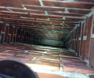

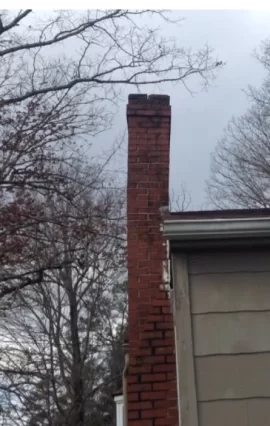

How about some pics.....
I would have to see it but many times we will drop a liner insulate with pour in mix that helps stabilize it and then if need be add support and re point. But it is also very possible it is beyond being worth fixing we need pics to have any idea

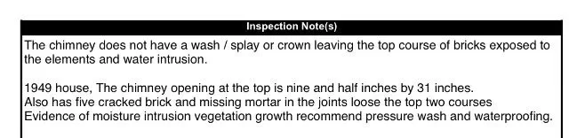

[Hearth.com] 1949, one brick thick, wobbly chimney [Hearth.com] 1949, one brick thick, wobbly chimney [Hearth.com] 1949, one brick thick, wobbly chimney [Hearth.com] 1949, one brick thick, wobbly chimney

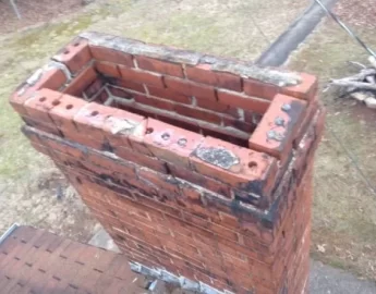

jatoxico - When my husband is standing on the roof he can push the top of the chimney a couple inches from the house. We do not use the fireplace and chimney.

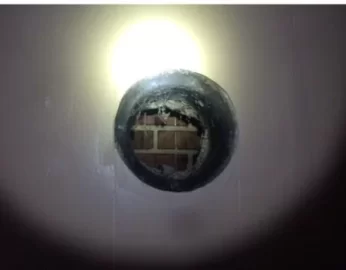

That chimney looks worth saving to me it looks like it needs a few courses at the top relayed and needs some flashing and pointing work but not to bad.

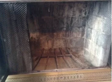

Has the fireplace ever been used? The chimney looks exceptionally clean.
I'll leave it to the experts as far as what your options are. Are you looking to put the new stove in while saving the old hearth? Guess it comes down to what the repair costs associated with the old chimney would be vs demo and new pipe. Take a pic of the fireplace. If it's nice it may be worth saving.
That helps. It looks like you can go with either a rear vent stove that is low enough to vent under the lintel or a top vent stove. Tell us a bit more about the house and location. How high up in the mountains are you? How tightly sealed and insulated is the house? How open or closed off is the first floor plan?

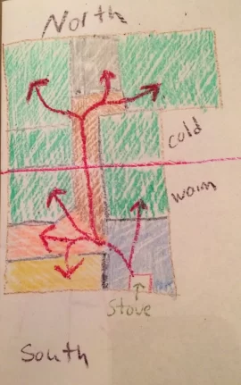

Forgive the crayons. I needed to let my inner child out. :)
This is a basic layout. The stove will go in the livingroom in the south east part of the house. A large doorway is in between the livingroom and the rest of the house. It is 5' wide and 6.5' tall. The red arrows show the airflow from the stove to each room.

To improve heat distribution to the north end of the house you are probably going need to put a fan where I put the red oval. Put a table or box fan at the far end of the hallway, placed on the floor, pointing toward the woodstove. Run it on low speed. It will blow the cooler air down low, toward the woodstove. The denser cool air will be replaced with lighter warm air from the stove room. Running this way you should notice at least a 5F increase in the hallway temp after about 30 minutes running.
