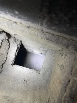

1 – While looking up from the ash dump clean out they noticed there is plywood under the hearth or concrete footing. The inspectors really made this seem like an absolute “disaster”, although they mentioned it’s in approximately 50% of homes. They asked multiple times if I was sure that I really wanted to go forward with the cleaning, basically implying that the fireplace is completely inoperable because of this, so why would I even want to have it swept.
I didn’t realize until they left that the plywood is 12 inches from the top of the floor in the firebox. I mean, do I really run the risk of wood combustion from 12 inches of concrete in between? The plywood is actually in perfectly fine condition without any burn marks or charring. We also have the ash dump covered, so there is very minimal debris escaping down there, if any at all.

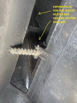

2 – They noticed the flue that vents the hot water heater and heating system (both gas) is exposed in the firebox. They were worried about damaging this if they were to perform a sweep. They said this should be covered with concrete. I doubt it was ever covered with concrete, and that it all broke off over time, but who knows. Does this seem like a major issue? I don’t know if this is the terracotta that is exposed? It also has some pretty consistent lines on it, as you can see in the picture. Anyone know why it would be stained this way? Obviously I don’t want to do any damage to this, as I wouldn’t want to allow any carbon monoxide to seep through and backdraft into the living room. It's tough to tell in the picture, but this exposed flue is at a 45ish degree angle from where it becomes inline with the fireplace flue to run parallel vertically up the chimney.

The wood under the hearth doesn't meet code and should be removed. But I don't see much safety risk from that concerning the fireplace.
The furnace flue is a complete mess. And the exposed liner in the smoke chamber would make me not clean it either honestly.

The foundation of my chimney in my crawl space is concrete block, and there is also wood support in my ash dump. Also about 12" down. I never use the ash dump; I've got some cracked hearth tiles around the ash door and I always worried about embers getting down, so I just got a metal ash tray to cover most of the floor of the firebox. No longer concerned.
There is still a concern about heat transfer through. But at 12" thick I doubt there is much danger there. Unless you keep the fireplace going for days straight.
The furnace liner in contact with it is a big problem though in the one shown

As for the exposed flue in the smoke chamber, what types of possible solutions could we be looking at? I'm sure it's not a cut and dry answer, but just trying to get some ideas before the next inspection.
