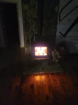

My first fire of the year as well.went down to 32° this morning.burning uglies up.
