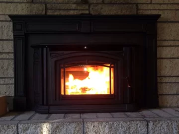

Hows this look? Used super cedar and some tiny splits/kindling.
Should i throw 1 biobrick in? Stove shop said to do a duraflame log but dont think those are good.
Any thing i need to pay attention to? Should i just this small fire go out and do bigger one tomorrow?
Also fire seems to slow down alot with door locked, But with Cracked open its much better

The stove and installation look really nice.
Do you have a good, well seasoned wood supply? Just wondering why you would need biobricks or manufactured logs. If it's just a matter of getting a break-in done, you can just use your regular wood and get the stove to about 600F for awhile. Maybe three of those.
Edit: I think I remember now that you were worried about the quality of your wood supply, is that right? Then, yes, you can supplement your wood with biobricks, pallet wood, North Idaho Energy Logs, etc., if available to you. You'll have to figure out a good proportion depending on your wood. Don't overdo the biobricks, though.
