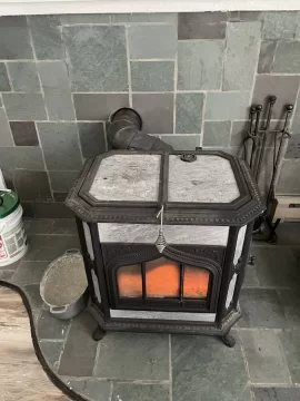

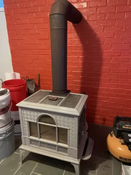

I have attached the photos of the stove. The chimney is clay lined(?)
What I want is to use both stoves at the same time.

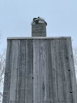

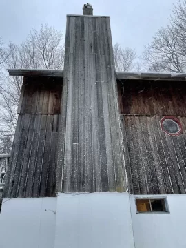

That's a very wide base for just a chimney. Was there a fireplace at one point behind the Fireview? The chimney at top looks tiny for the large base and exterior bulge on the house. Do you know what the ID is of the chimney flue?

Yes, apparently 30 years ago the original fireplace & chimney was removed and a clay pipe chimney was installed with the two stoves.

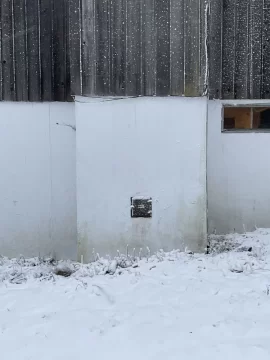

Do you have a prior chimney sweep report? The tile ID should be written on it. Otherwise, this depends on the construction. If the tile size stayed consistent then you might be able to measure it through the cleanout. Or, pull the stove pipe and try to measure there.
I am wondering where the basement flue joins the upper? For that, a sweep would lower a camera down from the top. The thought being to open the exterior up at that location, remove the connection, patch the hole, and run an insulated liner down each one. This is assuming an outer casing of masonry. It may take removing the top cap to see how this was done.

One stove per chimney flue, judging by the cap it looks like you have (2) stoves into one chimney.
IDK whats behind the chase (over sized chase to smaller masonry block chimney?) don't know unless its looked at carefully.
