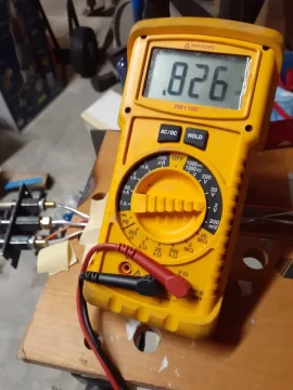

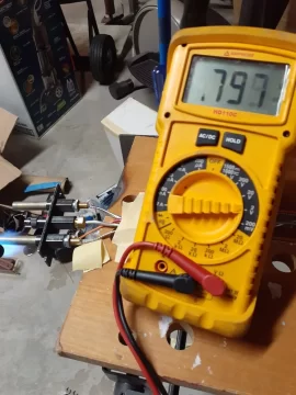

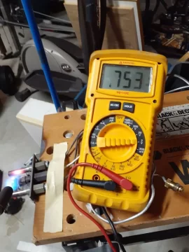

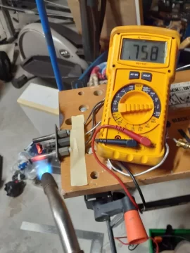

With a propane torch on the bench, I got over 750Mv on all four!
