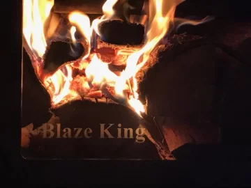

In an effort to get the most fuel in the box I was getting pretty skimpy with kindling and then loading outdoor temp, big splits, tightly above the kindling to the roof. I should clarify that most times I am active before the hour is up but with the top down method I use the same amount of kindling on top where the kindling energy boosts flue temps and cat temps more than spending energy warming up the bulk fuel load.
No super cedar for me. I'm all about the torch now. Previously I used a golf ball sized chunk of wax type firestarter which was likely not as intense as a supercedar.
New routine is just working way better. I am getting the same amount of fuel under the kindling as I was before but it's easier to load.
I am certainly not the first person to be happy with the top down method but before I had bad luck with it.

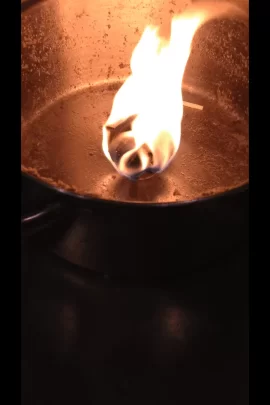

I use pine splits only. No kindling. For starting a Rutland starter square with ONE drop of lighter fluid on a corner. Instant starting. When I close the bypass, the cat is immediately aglow, with no elapsed time.
With the Meeco squares, I can actually reduce that to ZERO drops of lighter fluid, but it doesn't start instantly, it takes one second. Plus the extra time to split the wafer in half. ;)

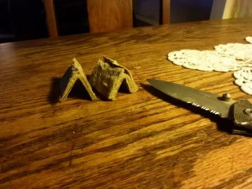

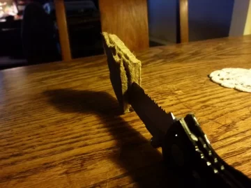

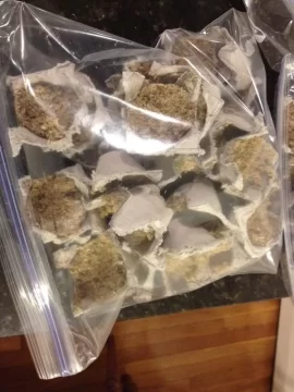

On the fire starter topic I recently made a batch of my own recycling a bunch of otherwise household waste. I save paper egg cartons, sawdust vacuumed up after I cut wood, and bacon/cooking grease. I buy cheap ugly candles for the wax and melt them down in a double burner setup. Stir in the sawdust and cooking grease and pour the mix out into the egg cartons. Once they dry I saw them up into little starters. Considering I only buy the candles it runs me about $0.03 per fire starter. They burn hot for almost a full 10 minutes.
I've been reloading on hot coals for about a month now, but these will be handy in the spring shoulder season.

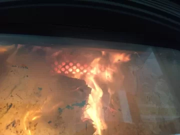

Another benefit of the top down fire with a freshly cleaned glass is the nice fireshow right from the start.

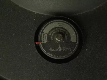

Going back to the earlier point of driving by flue probe vs cat thermometer, here's my stove on a cold start this morning. Glowing cat, probe thermo reading dead cold. It is far too slow to be of any use, here.
