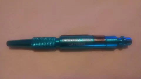

Check if you can find something like this in an auto part place. it works good. You can adjust it at the tip.
That looks like on of the old fashioned brass nozzles for the hose. Trouble is, to blow through the cat installed in the stove there is very little clearance up there behind the airwash.
I think it works fine with the ceramic cat. i just point it to the holes but not in a straight way because of the clearance like you said. I did it but not because it needs it. Maybe with the steel cat is different.
