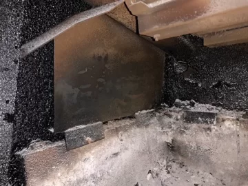

I run my stove on high lots, and can clean the glass off from doing this no prob. But, i’ve Never been able to burn off the creo in the box. Looks like a scaly dragon in there all the time. Is this something that folks should be inspecting for on these stoves? Gotta think that the low and slow feature would give a lot of people creo build up in the box?
It was warm as hell here (70) in the middle of the winter so I let the fire die and scooped out all the ash. I noticed creo on the sides and back. I could easily pick it off with my finger though. Is this normal? I do try to run on high for 30 mins every chance I can on a reload but not always possible.

That is a pretty ugly pipe. Are you monitoring flue temps? Even though the cat is active and eating what it can, this stove is so efficient that it can maintain very low flue temperatures even when you’re doing everything right. Low enough flue temperatures to allow condensation in the flue. These stoves aren’t zero emissions so if your flue temperatures are low enough to condense then it will be creosote looking stuff.

come on now, there’s a huge spread between maintaining noncondensing temperatures in your flue and what a noncat would puke up the stack. You just need to be above the condensation temperature which is like 250 at the top. I aim for 400 internal temperature at 18” above the stove.
