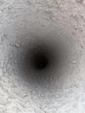

Swept the chimney after my first year with my King, looked good. Everything was fluffy, had about an inch in the bottom of my ash bucket I put under the flue when sweeping. My stove lives on low, so that little accumulation is fantastic in my opinion.
Cleaned mine yesterday for the first time since my princess has been hooked up. Not really any different then when my Summit was in use, just a small amount of light fluffy buildup.
Good job. Proper operation and proper fuel/ maintenance!!
The way you describe it makes me think you have an "out then up" chimney system where the 22' of class A is all on the outside of the house? That's not much creosote for such a cold chimney. Do you keep it running hot all season?
