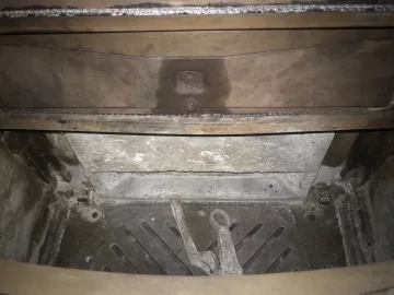

So this year I bought gasket kit and replaced for the doors, glass, griddle, ashpan, flue collar, damper. The damper was the hardest. I ended up applying the cement with my finger onto the fireback and thought it would do. But realized the bottom of damper does not create tight seal like the rest of the sides. There’s a nice little visible gap see pic below. It sits too high once closed like the bottom of the damper is almost level with the top of fireback! if I can only bring it down then I think I’m in business. *Can someone please tell me if there is a way to adjust it to go down so I can have a tight seal??(Encore 2n1 2040) thank you

Well here is the back, I would think these tabs are loose or bent. You might be able to check them from the front with the door open. Hope the door isn’t warped....

I’ve seen them. I definitely loosened One of those through the flue collar to get damper off track so I can cement fireback. I’m thinking I may have not tightened it back all the way. If I need to, is it difficult to get the whole damper out? I assume I would have to take the top off
Can you get the flue collar back off easily to take a look? Probably can get everything you need to through there. I’ve done the full gasket through the flue collar opening before.

To me it looks like your damper is starting to warp. Not sure on the 2040 but very common on older models. It happens due to over firing the stove. I would use thicker gasket in that problem area.
