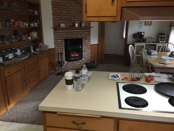

We just love Kuma so far. Very easy to operate, getting 10+hour burns between reloading, blower is very quiet on the lower setting, and puts out a ton of heat for a smaller unit. Our stove is located in the Kitchen/dinette area which is in the middle of the house. Yet we are able to run it low enough so we don't roast us out and still warm the whole house nicely. We have a 1500 sq. 60's ranch. We run without the surround so we have more access to the stove top for warming etc. We also get more radiant heat I feel. The Customer service is outstanding also. Jason and Mark helped us before the purchase and during the install when we had questions. One item I'm not a fan of is the blower thermostat is on the cord rather than the blower. I need yet to see if I can't shorten the cord and mount the dial on the wall so it all looks nice.

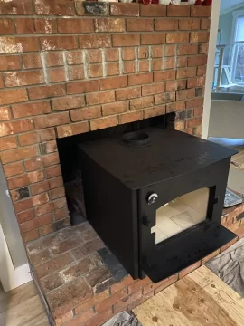

We just installed the Kuma Alpine a few weeks back. We just love it! Are you adding a blower?
A blower, maybe, powering it is a bit of a problem with the stove in the middle of the room. Gonna try one of those small fans you sit on top of the stove first. Glad to hear you are happy with your stove! I can tell already this thing is an entirely different animal from my old 21.
I just ordered one of those fans yesterday. Going to set in back and see if it helps move any air. If nothing else they look kinda neat.
FYI, the blower makes a huge difference as far heat output. Plus its nice to have to cool the stove down if needed.
