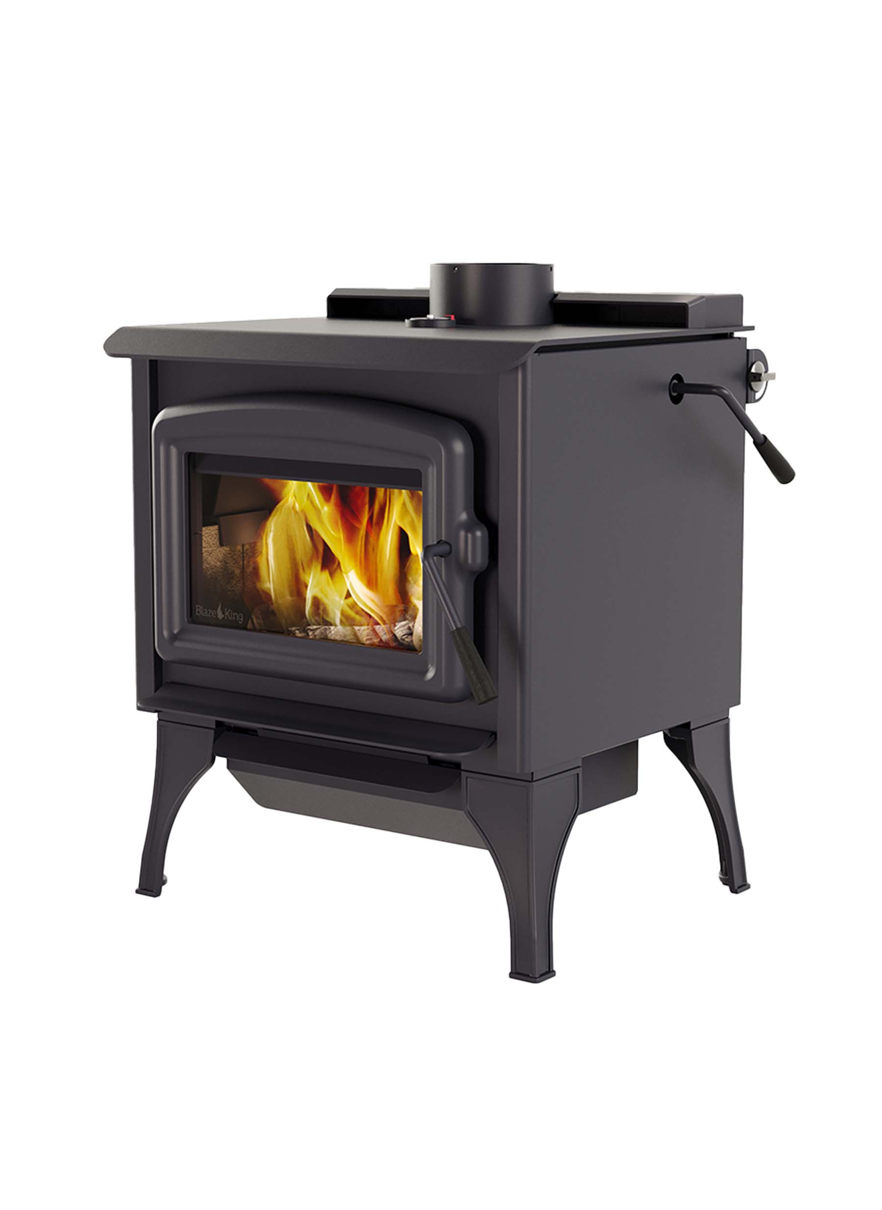

Forgive me if this has been asked before or is in the wrong area.

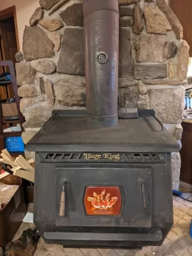

We are going to change out our blazeking king? to an Alderlea T4 . The Blazeking overheats the house quickly (917 SF 2 room cabin)
with just a very small fire. I have a massive stone hearth and chimney that is the terra cotta flue with 6" single running thru that to the stove.
Are we going to be ok to run single wall with this new stove? We are weekend and cold snap users.
Thank you in advance.

Non-cats can run low. We do it pretty regularly. Plus the cast iron jacket will soften the heat quite notably. The old BK has no side shielding and is seriously oversized, but you may not want to go the opposite direction unless the stove is mostly for nights and weekends.
May want to add some details. Chimney height from floor to cap is? Thimble height from floor to center? Do you have a stainless flex liner inside the terra cotta liner already? Isn't your current King connector pipe 8 inch?
In central NC almost at the SC border. Shelby NC . current set up is an eight-inch till the chimney then reduces to six. No stainless in any of this as it was put in in 1980. I am not afraid to leave the bypass open on the new stove all the time if needed

The Alderlea series stoves have no bypass. In your area you will be ok with the T4 or T5, though I lean toward the T5. You get chilly enough to need the heat. Are you expecting snow?
