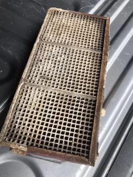

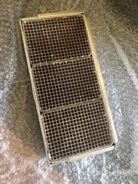

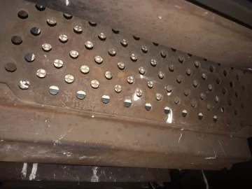

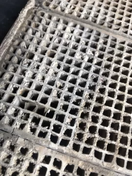

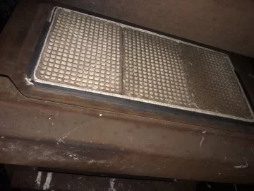

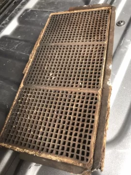

A little stove maintenance yesterday. I had bought this cat at the beginning of last season as I knew mine was on its way out, but I limped the old one along one last season. Popped the new one in the old showed some signs of minor crumbling and some definite ash build up. Looking forward to the new cat glow when this takes off for the first time this season.
View attachment 281425 View attachment 281426 View attachment 281427 View attachment 281428 View attachment 281429 View attachment 281430 View attachment 281431
I get that brown color and surface fuzz when they’re worn out too. Normally a grey up to the dying stages.

It had a good run 4 seasons through it, burning pretty much 24/7 Nov-March. Still held active on low burn right up to the end and still threw a nice shade of orange when getting settled down for the low and slow 18hr reloads.
It’s better to not push your luck to get every last bit of possible half activity out of these things. Get your efficiency, long burns, and clean burning back.
That's a nice 14000 hrs!

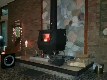

My Princess is no longer a virgin, it was like a classic movie: The Good , Bad and Ugly. Had a cool, rainy, breezy day last week and decided it was time for a test run. Followed the Instructions in the manual and all worked perfectly starting With no smoke spillage in the house GOOD. Anticipating the paint cure I had a couple windows open in the rooms around the Stove and boy was the cure process under stated in the manual. I had every window open and fan going to clear out the curing paint haze along with the smoke detectors all testing good(BAD). The stove worked perfectly and was as advertised in operation so very happy with that. The ugly was later that day I took my 5 yr old boy to the dentist, he was nervous but did good the whole time. Got back home and was helping him out of the truck, and He puked all over me. What a day!
Tinkered a little: full clockwise rotation “high” is 6oclock. Room temp before stove started I could hear plate close at 130. After my 20 min burn in, turned the stove down twice, once to 430 then 300, temp probe stayed half way in active at 300
Reactions: Alpine1 and Nealm66
