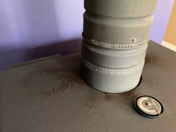

Okay, here's part 2 question. My buddy was just over and swept. A bit of soot seems to have leaked out the seam where the telescopic pipe connects to my stove top adapter piece (in the pic, at the top seem). It's double-walled pipe. I realize that soot is very fine, and can penetrate things pretty easy, but is this normal or something to be concerned about?

Normal..
But if you leave the loading door open when sweeping that won’t happen…. Lol

hahahahah - thanks for the reassurance, and you got me there! maybe next time i'll try with the loading door open... :)
