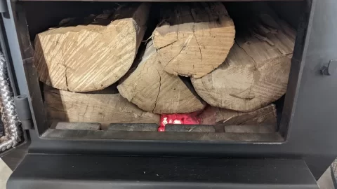

Awesome splits! This is what I'm aiming to make out of the wood I put up this summer. That looks greatFor the last 3 winters, when it gets cold, this is about 60 to 70% of my loads.
