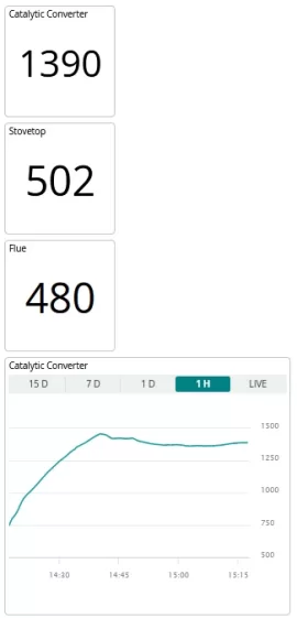

I like to keep the cat between 1200-1450. I have my alarm set to 1550. If you are hitting 1700 on the regular than you will be replacing a lot of cats. I think the coating on the cat starts to deteriorate around 1600. In this shoulder season weather smaller fires will keep the house tolerable. This in turn means you are splitting a lot kindling and starting a lot of fires, however, your glass will be cleaner and your flue cleaner as well. I do admit though that I will fill the stove half way and turn it way down once the cat is up to temp. This will give me enough coals for the evening fire. If it gets to hot in the house you can always open the windows and dump some heat.What is the operating temp range of the cat? What do you do when it goes over the recommended high temp? Open the bypass?
