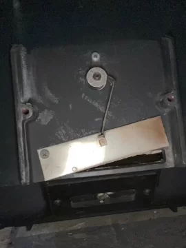

How do you mean? The secondary flap, or are you talking about the epa holes?
Secondary flap. Remove the screw, let it drop, seal with aluminum foil. Did it 3yrs ago and it works.
That temp is definitely cooking. I would cover up the secondary air with some foil tape
Sure it is not EPA approved, but it works. VC engineers…..you suck (Corey you are in sales right…..).
So remove the pulley. Remove flap screw. Insert layer of foil. Reinsert flap screw.
Do I have this correct?
[Hearth.com] 2021/22 VC Owner thread
Like this. It does not have to be waterproof.
So did you take the flap off, tape the hole, put the flap back on and then tape over that again? Or just tape the opening the closed flap doesnt cover?
Tape over the metal flap.
