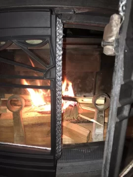

Guys familiar with the 2550. Are you putting gasket down the handle side of the door where it overlaps the other door or just gasket on the non handle door?

Here’s the door side Gasket runs all around

Picture above shows handle side door with gasket running the perimeter of the inside of the door. Sorry for the crappy pictures
No worries. And did you wrap the gasket around on the left door and run it down the outside of the door on the mating side?

As I recall one door has gasket all around and the other has a gap. I am letting my stove go out (relatively warm out), will check in the morning

It’s alive! Just going to do a small fire right now to cure the gasket cement. I ended up running the gasket on the left door down the front groove and nothing on the mating edge of the right door. I also included a pic of how I clip the probe wire to the stove.
I just did my door gaskets. where they meet i only have gasket on the non handle side. Thats how its always been, for me at least
View attachment 284329 View attachment 284330
Thanks for the probe pic! I didnt know they made high temp ones short enough to not have half the probe hanging out. What probe is that?
Also, I didnt want to take the shutter cover off so I used a hanger (see pic). It's super ghetto but I will be looking for a way to use the same metal clip to hold the wire.
The probe itself is a condor probe. I had a crappy over priced condor digital probe before my AT100. It’s a 4 inch probe. I believe Auber only has a 6 inch. I have the back heat shield on my stove so leaving the shutter cover off isn’t a big deal for me. I didn’t even install the secondary probe in this new refractory box so the shutter is shut permanently
