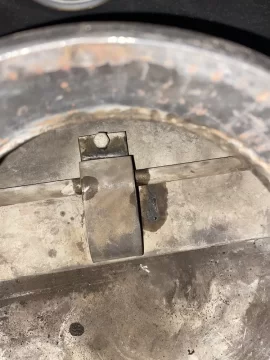

Getting ready for the new season, replaced my cat and door casket. I noticed today my bypass lever is not clicking when I close it. The Manual says to adjust the tension. How exactly do I do this?
After taking my top stove pipe off I see the problem the metal plate behind the cat sits in two grooves. The metal plate is out of one of the grooves. I can manually put it back in place however it comes out of the groove when the bypass is opened and closed. I can attempt to take a picture if it would help.
Loosen up the cam shaft bolt that adjusts the by-pass, it might be to tight, make sure there is no debris between the by-pass plate and the flat gasket, then actuate the opening and closing of the by-pass until you have the right tension - snug dollar bill between the bottom of the plate and gasket, it doesnt need to be tight, just a little snug.
Is this the cam shaft bolt?
[Hearth.com] 2022-2023 BK everything thread
I may have solved the problem the bypass rod was catching I used a small amount of lock fluid and it doesn’t catch anymore and the plate stays in track

Also keep in mind that chimney sweepings tend to sit on the bypass door gasket, and mess up your damper tension, until vacuumed or swept clean.
