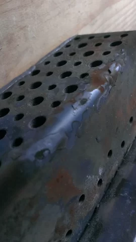

Here is another update in the ongoing burn-pot saga. First, an update on the 2nd replacement pot. I've burn a little more in it since I last posted in this thread, but not a lot as I've run out my supply of pellets. It has continued to erode much the same as all the others. I have no doubt that I'll have a similar failure with that one before too long. Also, the performance of that third pot is very poor compared to the first two burn pots I used. I believe it is leaking around the flange, it runs significantly richer than the other two pots.
Two days ago I was able to get 16 bags of an alternate fuel and install my 3rd replacement burn pot, the 4th new burn pot I've burned in this stove this year. I picked up 16 bags of Cheat River pellets from Lowes. I cleaned the hopper out, purged all the old Heatr's pellets, and fired up with the new stuff. The test here was to attempt to prove/disprove if the fuel was causing some sort of chemical reaction that was accelerating the erosion of the burn pot. Well, after only about 24hrs of running this burn pot is proving to come apart just like the others, with thin flakes of metal falling off, primarily on the front bottom in exactly the same place all of the other pots failed. I'm not sure what else to do with this problem, other than have a higher quality pot made. I'm going to reach out to Englander and see what they have to say, but my expectations arn't high - I think it's really as simple as just a cheap pot. I'll let you guys know if anything further develops.
  • [Hearth.com] 25-PAH Premature Burn Pot Failure - My fault or the burn pots? (2 burn pots in 4  months)
