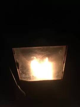

I know that the 25-PDV is not perfect, and everyone has issues here and there, but I need to know what a good flame looks like in this stove, anyone want to share a pic or video?
When I get home from work I’ll try and post a video of my flame. As far as the blower ramping, I’m not sure I have noticed it or not. The room blower makes to much noise lol
[Hearth.com] 25-PDV Control Board
This is mine set to 561 bottom 3 numbers and heat on 2
  • [Hearth.com] 25-PDV Control Board
Here's mine, for another reference. 25pdv, heat range 1, blower 2, bottom three at 5-4-1, D mode
