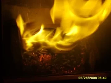

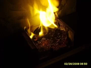

I have noticed that the pellets do not seem to burn all the way, they bunch up in the burn pot after 4-5 hrs use. I have seen this on all settings. I can hear the top auger turn on and off. I have closed the metal plate as far as it will go in the hopper, still same problem. This has happend since new with both kinds of pellets. I could take a couple pics and post them later if it would help. Thanks for your time guys

Here are a couple pics after 6 hrs on a setting 0f 3-3. I cleaned the stove out real good about 8 hrs before these pics. I am at work till 5 but will call tech tonight to see if they can help me and of coarse I will watch this thread :) Thanks for the help so far guys. oh and sorry for the dark pics

I wonder if there was a style change on the burn pot because the large air hole on the side of the burn pot is underneath the removable grate on mine. It almost looks like the burn pot was assembled and welded incorrectly. Just my $.02
Hey Moto…
I have a one week old Englander 25 and using Barefoot pellets as you are. And I live in upstate NY. (Nice weather huh?) I'm seeing the same thing you are. They seem to burn real hot, but they do clump up as seen in your pictures. I'm thinking that we need to try another brand of pellets, even though I can live with this due to the heat they put out. Let me know if you try another brand and how they burn, and I'll do the same…I've tried, as Mike from Englander suggested, to up the air intake feed to 7, but seem to still have the clumping. Only way to really figure it out is trying other brands, before I can blame the stove itself.
I have the same stove and i agree with the post above,i think the burn pot was welded wrong.the 2 air holes on top
in the pictures are underneath my burn plate.i dont think it is getting the air flow needed.

I agree. I dont have that stove. I have a Quad Castille.....and when my air flow gets blocked with ash it has similar flame. I dont like to let it go more than a day without dumping the burn pot...runs better.

look under the wear plate and you will see two more holes like that at the bottom , this burn pot is supposed to have those holes at the top. unless the unit is built prior to 2002
