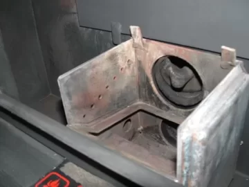

I still think something might be up with your burnpot. Here is a pic of mine manufactured in 10/06. Jusy my $.02
My englander burnpot is different than your picture. My air holes are in a straight line going across .......here is a modified shot of your picture showing what I mean..........I get a aweful lot of clumping too with mine.........Must clean it out as it's ready to overflow the top of the pot twice a day. Got a little tech support from them & it's better, but still more than I think should be there.
  • [Hearth.com] 25-PDV questions/concerns
I get a lot of ash in my burnpot in a 24 hour period and tried different brands of pellets without much difference between brands. Some just seem to leave more clinkers than others. The original poster of this thread, moto, has the larger burnpot hole on the topside of his pot. For some reason, that just doesn't seem right to me. Just my $.02.
