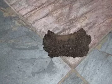

Well guys, I'm back. I talked to Mike from englanderstoves before leaving and we narrowed it down to a poorly modified burn plate (whichever if fixed), a possible going combustion blower and a change from "b" to "c" in the control settings. Well, a few days of trying and we are a bit better but the clinkers are a huge problem. The pics from the link are after 18 hours on mostly settings 5-8, lots of ash in the heat exchanger and huge clinker build up (clean around the air holes every 3-5 hours). Burning somersets, so the pellet is good. What do y'all think?
