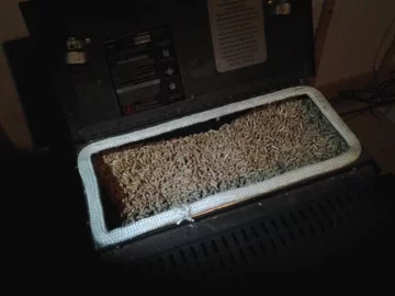

What kind of gasket do I need for the (dennis) Hopper door?
and
good sources (ie inexpensive) places for it??
Thanks :) and Happy Holidays everyone!

The hopper uses a "flat" or "tape" type gasket..
A 1/2" or a 5/8" flat gasket will work fine. Most stove shops or even hardware stores will have them. If you don't want to wait or pay for shipping.
StevieB Thanks. I would like to support Englander but $32 is a just to high. $12.50 for shipping? The $18 custom fit thing isn't bad though.
-Thanks Dexterday I will be at the hardware/stove store today or tommorow.
Did the dollar bill test on the hopper door and it slides right out. The stove door was aok.

Kenstogie,
I agree, that is pretty steep for one gasket. The hopper lid latches are adjustable if the gasket is still ok but just compressed.
Dexter has a good idea. Thats how I replaced the door gasket on my king stove. The one from the hardware store needed trimmed a little bit but was a good gasket for the money!

Yeah as SteveB mentioned above. The hopper lid latches can be tightened
Foo for thought??
Unless the gasket is "Smooshed" real bad? Then spend the $10 at the local hardware.
Yeah I am going to try and tighten the hopper lid latches and see if that does it that may cause a lazy burn. They do seem somewhat smooshed but I have no frame of reference to compare them too. So today I have to do the LBT and adjust the lid latches, reseal some leaks in the dura leak exhaust venting and .... That'll be my project for today..

yea i try to go oem asmuch as possible,unless its considerably cheaper. i just adjusted the hopper lid and its better but could use new one. A am judging this based onthe dollar bill test.

Well the hopper lid was better after the adjustment and ok for a while but while at Lowes I saw a 5/8th 7ft section of fiberglass gasket for.... $7.50 or thereabouts and it came with the cement. Sold.

so early sat morning i did the usual pellet stove maintenance and while i was at it i replaced my hopper door gasket. i used a 5/8 rope fiberglas type that was at lowes for 8 bux and it came w/cement. it is a tight fit (especially near the hinge) but does work, if i had thechoice i think 1/2 inch would bebetter. [Hearth.com] 25 pvdc (easy question) d be better.
