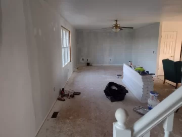

Thanks for the quick reply. Currently, there is not a chimney in the house; I know that will likely be our biggest upfront expenditure. The living room where I plan to put the stove is roughly 30' x 20', with an open layout to the rest of the main floor. My thought was to put it on the outside wall.
The room is currently under construction, as I ripped out a non-load-bearing wall next to the stairway, to open up the house for wood heat. Am I reading correctly, that wall chimneys are not ideal? Should I plan to go through the roof instead? Any assistance is appreciated. Thanks!

We had planned to put the stove in the left corner, but going straight up with the chimney would be a challenge, given the dormer on the roof directly above. We had considered going out the wall right there, but then again, that's an eye-sore right on the front of the house.
We're hoping to stick under $3k for the stove, and then we're aware of the chimney costs on top of that. I'm hearing Drolet seems to be the way to go?

I am actually thinking potentially I'll could put the stove in the right corner (rather than the left corner), and that would allow me to go up and then out through the garage attic, close the top of the garage roof. I'd likely have a pair of 45's like @EbS-P suggested, but it sounds like that's acceptable? Since it's a 2 story, and there are front and rear dormers, where I can go through the roof is limited.

Without seeing a complete floor plan, that does sound like a better plan. Two 45's are definitely better than 90's. There are rules of thumb chimney installers (where's @bholler?) use to "discount" a few feet of chimney height equivalent for each 45 or 90, but someone else will need to remember them for me. Point is, if you go thru a soffit, given the pitch of most cape cods, you're going to have a lot of pipe in the air to both meet the 10-3-2 rule and your stove's minimum height spec. Going thru a higher point in the roof resolves both of those issues.

It sounds like the right corner location might work out. The loss equivalent from the offset is about 2ft in height. Drolet's are easy breathers so it's likely this offset wouldn't be an issue for this installation.
We have a pair of 45's in the stove pipe making an offset to line up with the chimney support for the prior stove. The overall flue system height is about 20'. It performs well with our stove.
