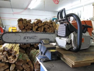

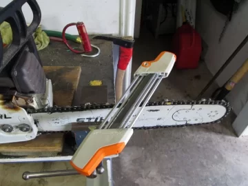

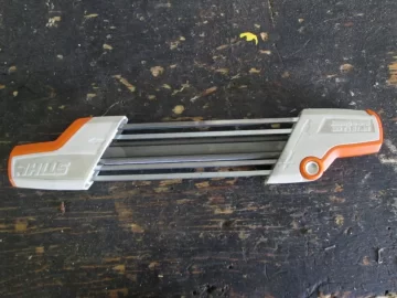

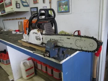

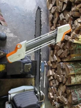

I've been using the Stihl 2in1 for the last year or so. Love it. I tried just about every gadget in the past 3 or 4 years that promised to be a simple and easy system for sharpening, including the Timberline, and now I don't use anything else except the simple 2in1, and I use it every single time I touch up the chain. I've sharpened one chain right down almost past the guidemarks before swapping it out for a new one. I love it. Now for the only caveat: I only cut up and process tree length logs (36 - 42 cord per year) that are dropped nice and neat in front of my shop; all my sharpening is done in the shop on a bench vice located conveniently at the end of the bench so that after I finish sharpening one side of the chain I walk around the bar to the other side and sharpen the other side, easy as you please..... I smile just thinking about my 2in1.... the search for a perfect system is over.... :-)

Chuck
I couldn't say it any better!
This brought me back to close to a new chain ...
I recommend it over the Husky's.
I've been using the Stihl 2in1 for the last year or so. Love it. I tried just about every gadget in the past 3 or 4 years that promised to be a simple and easy system for sharpening, including the Timberline, and now I don't use anything else except the simple 2in1, and I use it every single time I touch up the chain. I've sharpened one chain right down almost past the guidemarks before swapping it out for a new one. I love it. Now for the only caveat: I only cut up and process tree length logs (36 - 42 cord per year) that are dropped nice and neat in front of my shop; all my sharpening is done in the shop on a bench vice located conveniently at the end of the bench so that after I finish sharpening one side of the chain I walk around the bar to the other side and sharpen the other side, easy as you please..... I smile just thinking about my 2in1.... the search for a perfect system is over.... :)
X2. Love mine. Greatest sharpening tool I've come across, by far.
Once you sharpen a chain with the 2 in 1 you will never go back to the old school files. I love mine!
